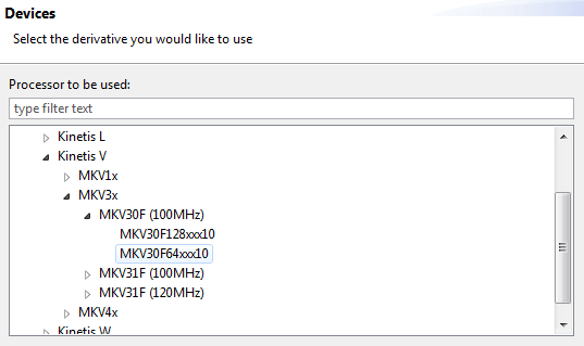

Is there  a pack for implementation of processor expert for  MKV30F64VLF10?

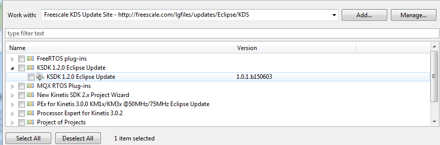

I changed to KDS3.2 and update KSDK 1.2 as below.
Then, in New Processor Expert Project appers the MKV30F64 option.

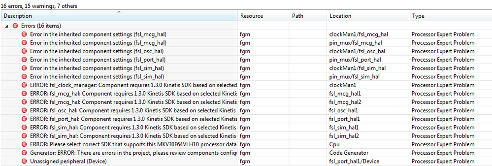

After, a select the KSDK Absolete Path, because its was necessary.
But, after project criation I get this Project Expert ERROS. Someone knows how to fix this?

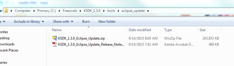

Hi Daniel,
You use SDK1.3, did you install SDK1.3 update:
Please also check if you install other kinetis related update also. If all above have been installed, you should be able to use processor expert without problem
see attached video.

Hi Daniel,
Please use KDS3.2 instead. This version should support MKV30F64.
