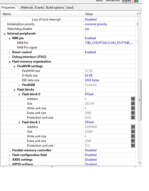

I'm trying to use Processor Expert for work with "embebed" EEProm in a Kinetis K20DX256 microcontroller. Processor Expert initializes the memory map (I use, for example, 1 KB of EEPROM and 16 KB of D-Flash.
The methods given by PE works fine with P-Flash but it doesn't work with EEPROM address. I need work with this memory. How can I do it? It is possible?

10,641 Views
vfilip
1st: Tell the Flash_LDD driver the size of EEPROM and FLASH using properties in CPU component. (Detail of CPU settings is attached)
2nd: Set corresponding size in debugger. (Detail of setting is attached)
You can find also some details in the following application note: AN4282.

10,641 Views
night
Fresh Out Contributor
Dear Vojtech Filip,
thank you for your answer. I do all that you said, but I have de same problem!
I configure the memory with processor expert (with the configuration present in 'memory.png'). The CPU configuration is the same (cpu.png). After I configure the size in the debugger, but I can only configure FLASH or RAM memory (EEPROM doesn't appears like you). The code used by me here is '3402' (32 Kb of EEPROM data size and 16Kb/16Kb FlexNVM partition code). I tried it with another codes with the same result.
Finally, when I use the methods of the memory (like NAME_EraseBlock or NAME_Write) on the 0x14000000 adress (the EEPROM adress) the method returns a error with code 137 = ERR_PARAM_ADRESS. I only can access to 0x10000000 or more (the D-FLASH partition).
Thank you very much and sorry.
Best regards.
Miguel.
10,645 Views
vfilip
it´s OK. However this is misunderstanding. You cannot use the Flash_LDD component to write into EEE area. You can use for example the code below:
*(word*)0x14000000 = 0xAA;
Please do not miss to check "3.3.1 EEE writes"/"3.3.2 EEE reads" sections in the AN4284 for details on flag checking during writes/reads.
