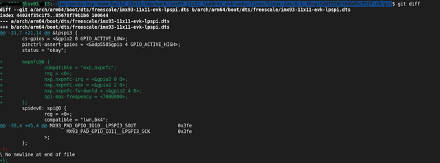

Step-1 Make changes to the dts file in your directory
example - arch/arm64/boot/dts/freescale/imx93-11x11-evk-lpspi.dts

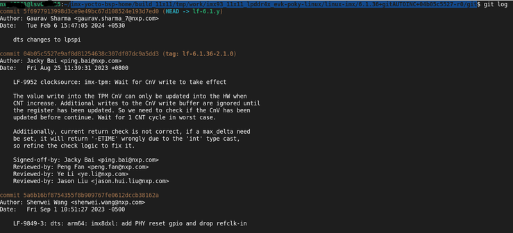

Step-3 Execute 'git diff' to check the difference between your changes and the default ones
Check the status by executing 'git status'
Step-4 Execute 'git add <file>'  , 'git commit -m <message>', and 'git format-patch -1'
to add a file and create a git format patch file for your changes.

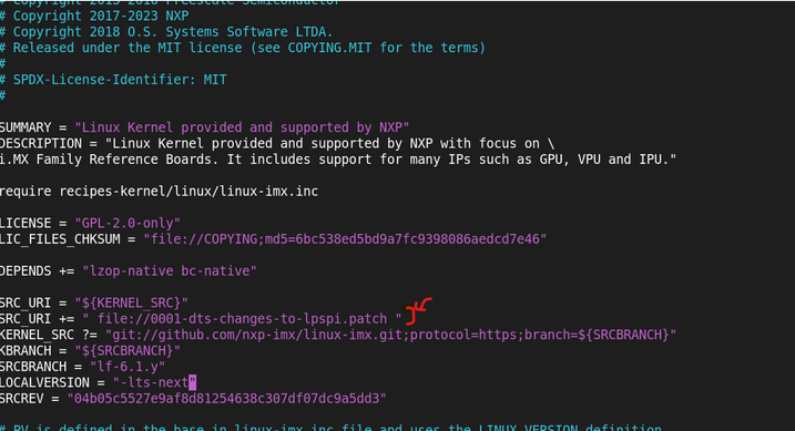

 Step-5 Edit the .bb file for linux recipes-kernel
for example - Open  /home/nxg06361/imx-yocto-bsp-home/sources/meta-imx/meta-bsp/recipes-kernel/linux/linux-imx_6.1.bb  for editing
Append the patch file name to the SRC_URI variable
You can also verify that your patch has been successfully applied or not by doing 'git log'
