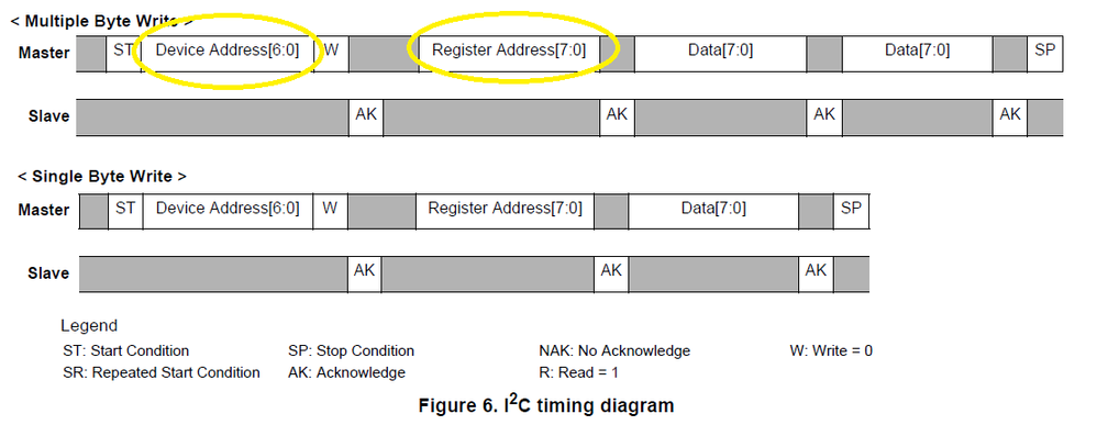

nikivendola
Hi Marek,
in the figure below you can see the time diagram of a MAG3110 I2C (slave).
The Master is a MK10.
The addresses  of Device and Register must be written first one then after tx, the other in I2C0_A1 register?
