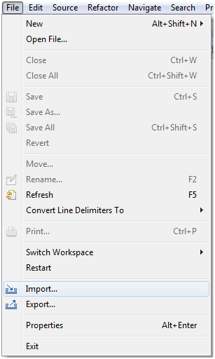

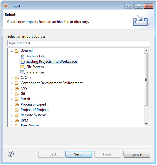

2. Import the project by using File > Import command, see below.
  • Select File > Import, from the IDE menu.
          The import dialog appears.
  • Expand the General tree and select Existing Projects into Workspace.
  • Click Next. The Import projects screen appears.
  • Click Browse and select the root directory to search for an existing Eclipse project
  • Select the projects you want to import in your Workspace
  • Check Copy project into workspace if want to create a copy of the project in the workspace (otherwise the project is linked into the workspace only).
  • Click Finish - the imported project appears in the Project Explorer view.

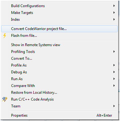

3 Convert CodeWarrior Project file by using command Convert CodeWarrior project file… in the context menu of the project in Project Explorer window, see detailed steps below.
  • Select the recently imported legacy project you want to convert.
  • Right-click and select Convert CodeWarrior Project file.
    Note: The context menu Convert CodeWarrior project file... will only work with GNU/gcc CodeWarrior project and not for CodeWarrior projects using the legacy Freescale compiler (for this compiler use instructions described in the chapter Steps of the conversion by manual configuration of the toolchain or Processor Expert project (CW MCU 10.6) migration into new project in KDS 3.0.0​).

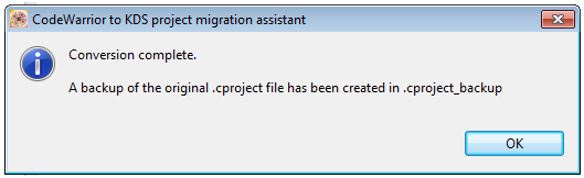

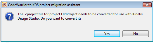

  • The CodeWarrior to KDS project migration assistant dialog appears and prompts whether you want to convert the project.
  • Click Yes.
  • The CodeWarrior to KDS project migration assistant will prompt that the conversion has completed and a backup of the original *cproject file has been created in .cproject_backup.
  • Click to OK to close the CodeWarrior to KDS project migration assistant dialog.
    Note: To see the conversion process log, navigate to the project's root directory and open the KDSConverter.log file.

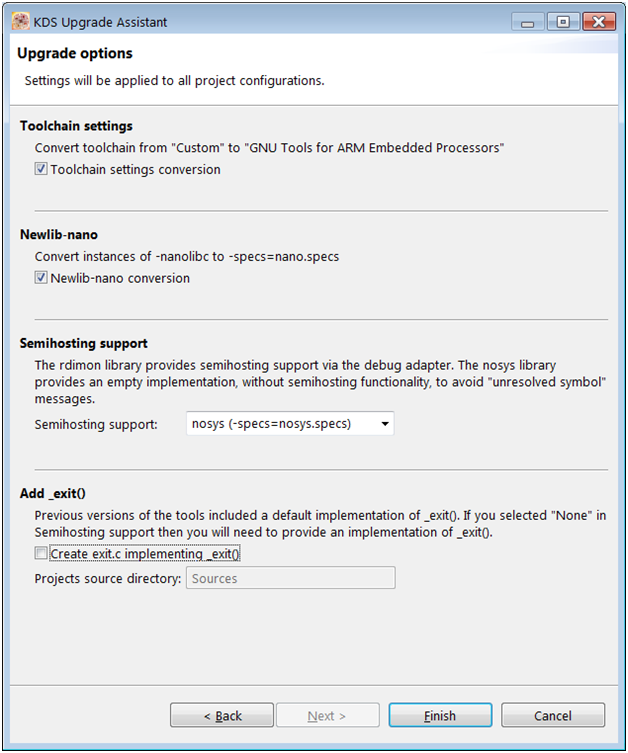

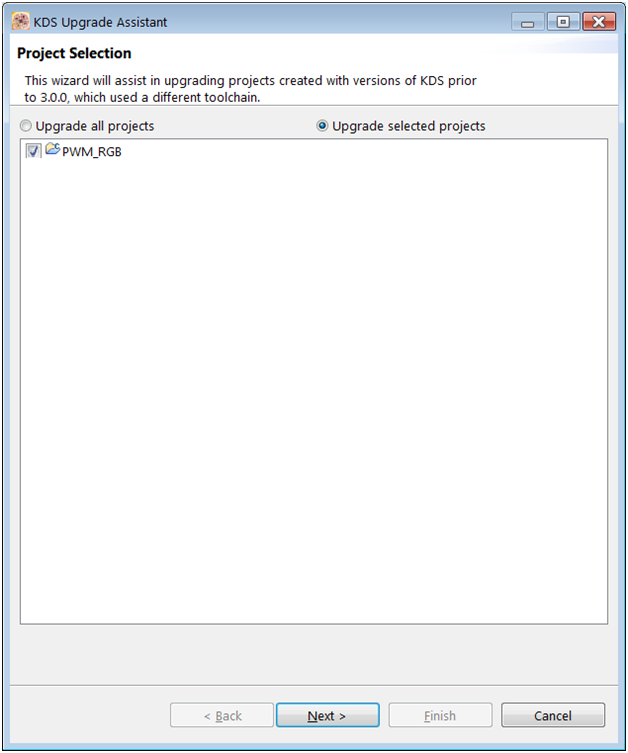

4. Process update of the project by using Project > KDS Upgrade Assistant…
  • Select the project:
  • Click on the Finish button to process the upgrade.

    • The converter does not distinguish between Executable projects and Static Library projects. In the latter case the options for converting Newlib-nano and adding semihosting should be suppressed.
    • When selecting options to add _exit() implementation and semihosting=rdimon on projects from KSDK_1.1.0demos\hello_world\kds a Cross ARM C Linker errors reports "multiple definition of _isatty". It is necessary to remove the user definition of _isatty.

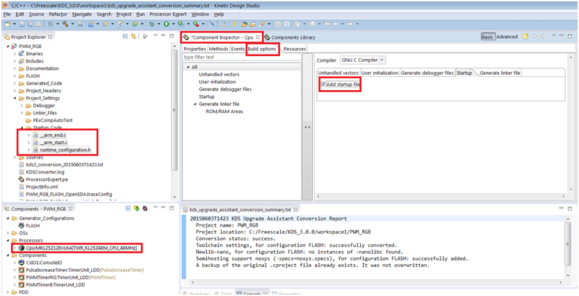

5. Remove all CW MCU 10.6 startup code (delete all files in the Project_Settings/Startup_Code project folder) and add a new Startup file by using Build options of CPU component:
6. Generate code (a new startup source code file is added into Project Settings/Startup_Code folder in the project).

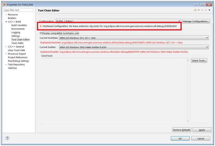

Toolchain configuration Issue
When you use the latest version of the GNU ARM Eclipse plugin you can get message "Orphaned CDT build configuration [org.eclipse.cdt.cross.arm.gnu.sourcery.windows.elf.debug.1561998926.1100932005.1237614533.626146708.187750101.514251714]: parent extension cfg [org.eclipse.cdt.cross.arm.gnu.sourcery.windows.elf.debug] not found".
The “org.eclipse.cdt.cross.arm.gnu.sourcery.windows.elf.debug” ID comes from a project generated with the old version of the plug-in, no longer supported. Recreate the project with the latest version and it will work. See also http://sourceforge.net/p/gnuarmeclipse/support-requests/6/
In this case you must create a new configuration from a template and set all options manually. Skip following steps and continue below in the chapter Steps of the conversion by manual configuration of the toolchain.

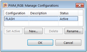

2. Select the C/C++ Build / Tool Chain Editor in the Properties of the project (see following screenshot). You see the warning message “Orphaned configuration ….”.  You must create a new configuration for this project (the current configuration is created by a previous version of plugins and it is not compatible).
3. Click on the Manage Configurations…

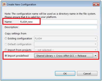

4. Click on the New button
5. Write the name of the new configuration and select the Copy Settings from. You can copy configuration from an existing project or you can use default template (the following description  suppose default configuration).
6. Click on the OK button. New configuration is created.
7. Select the old configuration and click on the Delete button.

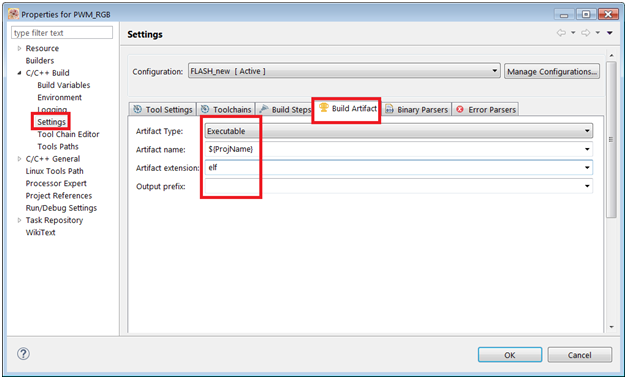

19. Set the Build Artifact (see below) and click on the OK button.
20. Remove all CW MCU 10.6 startup code (delete all files in the Project_Settings/Startup_Code project folder) and add a new Startup file by using Build options of CPU component:
21. Generate code (a new startup source code file is added into Project Settings/Startup_Code folder in the project).

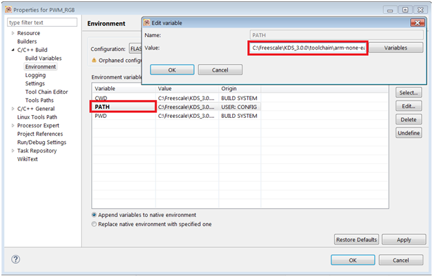

23. If you see the following error:
Error: Cannot run program "gcc": Launching failed
Modify the PATH variable in the Properties of the Project. Select C/C++ Build/Environment page, double-click on the PATH variable and add the absolute path to the folder KDS_3.0.0\toolchain\arm-none-eabi\bin\ (e.g. add c:\Freescale\KDS_3.0.0\toolchain\arm-none-eabi\bin\; at the beginning of the PATH values). Click on the OK button.
Build the application again.
