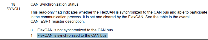

I am trying to get a CAN_LDD interface working on a MK60FX512 and I am noticing that the SYNCH bit in ESR1 of the Flexcan module is set, meaning that the "FlexCAN is not synchronized to the CAN bus."
I can only assume that this is why when I send data from the micro to another device, that the data doesn't come across.

Hello Mark,
-  "the SYNCH bit in ESR1 of the Flexcan module is set", this meaning FlexCAN is synchronized to the CAN bus.
- And pastedImage_1.png , could you please tell me which DOC ?
