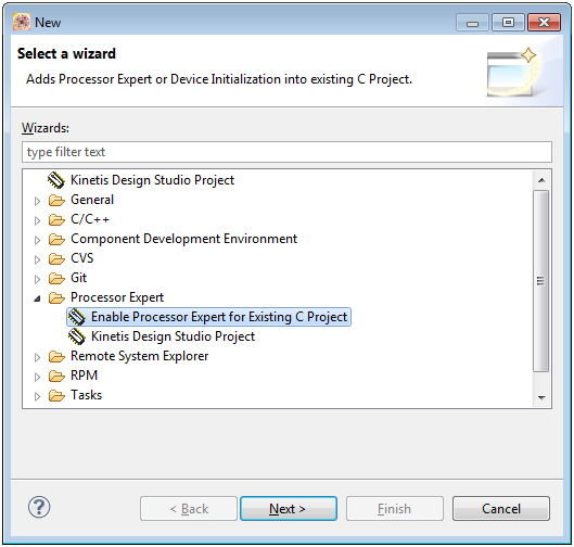

Steps:
  • Select the command in the main menu File > New > Other and in the New Project Wizard select Processor Expert / Enable Processor Expert for Existing C Project
  • Select the project you want to update.
  • Select the derivative that will be included in PEx project (you should use the same derivative with the _4SDK suffix that has been selected when the project was created without PEx).
  • Select the target compiler (select for example the IAR ARM C Compiler if the C project has been created as IAR ARM C project)
  • Confirm changes (renaming of main.c module and any other changes you want to apply) and click on the Finish button.

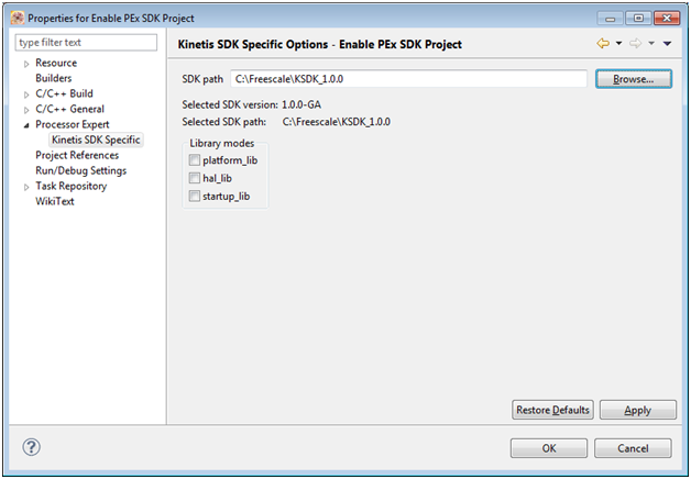

    • Go to project Properties to the Procesor Expert > Kinetis SDK Specific and fill the SDK path. Use browse button and select a path to the Kinetis SDK folder or fill the ${KSDK_PATH} which is default system variable. This variable points to the default Kinetis SDK folder.
    • After this project still shows some errors. Remove the PinSettings component from project and add new PinSettings component from Components Library. This process adds missing fsl_clock_manager component to the project too.
    • Press the button Generate Processor Expert Code and project should be generated without errors.
