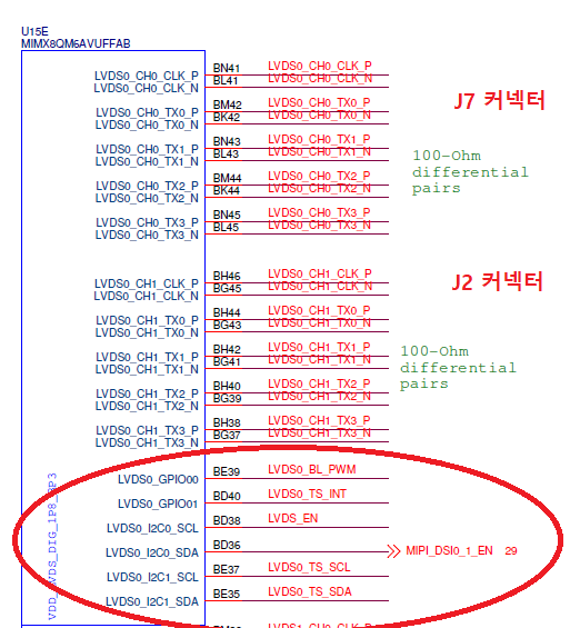

There's a request that Customer would like to solve.
They're trying to add a LVDS panel w/ Touch controller of Synaptic S3385.
Could you please us with Porting Guide to enable device especially focusing on Touch controller part?
This is asked since the NXP' porting guide does not handle the touch controller related part now.
They would like to clarify how to modify dts file to support a new touch device which is connected to I2C1. The interrupt line is connected with GPIO1 as below figure.
Please let us know how to modify dts file to enable S3385 device driver which was provided by Synaptics. i2c and gpio for interrupt and something else.

Actually I am not able to get appropriate info from the boundary device examples. Hope to add touch I2C controller into Porting guide.

unfortunately this part is not supported in nxp bsps, may be recommended to look
at boundary devices touch examples:
https://boundarydevices.com/tag/touch-screen/
https://www.digi.com/resources/documentation/digidocs/90002284/reference/bsp/v4-9-cc6_cc6qp/r_touch_...
