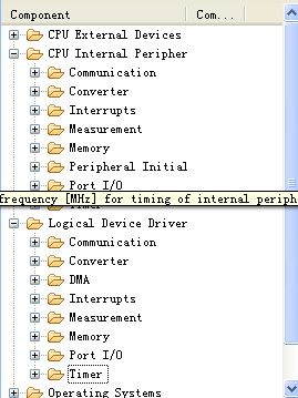

Processor Expert is shown below contains a variety of driver library
But there are many modules of the library is not present, such as SMC module , and if I need to use the SMC module function , do I only own the associated drive you to write ? Or Where can I find ?

this device should be encapsulated by the "Low power mode settings" and "Very low power mode" groups in CPU component. For more details please see attached screen-shot.
Anyway I understand your question. In future we plan to improve this settings to lets say peripheral oriented UI to avoid such unclear property -> peripheral assignment.
