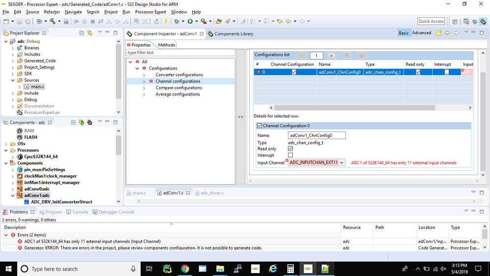

intern_praveena
how to solve this below issue??.I am using S32k144 EVB board.Screenshot (106).png

it looks like you do not use latest SDK (RTM 3.0.0).
I tested with SDK RTM 3.0.0 and I am able to set ADC_INPUTCHAN_EXT11 for ADC1 with 64pin LQFP package, please see the figure below:
Martin
