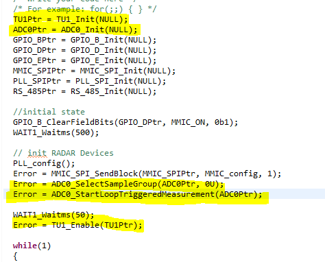

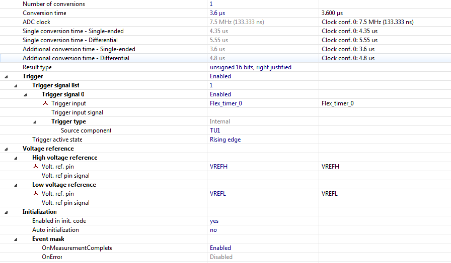

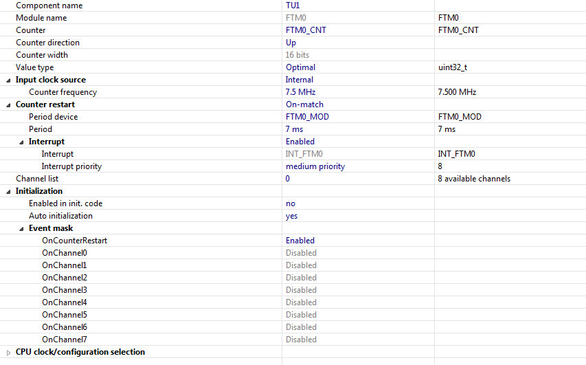

I want ADC0~ADC3 to be triggered by Flextimer for simultaneous four ADC results , so configured ADC0 (for just test) and FTM0(TU1) like below.
then, I insert init and enable code like below. I referenced 'ADC_LDD Typical Usage' in PE.
but This code is never interrupted by 'ADC0_OnMeasurementComplete(LDD_TUserData *UserDataPtr)'.
I tried SW triggered ADC, it's working. but HW trigger didn't.
I dont know what's the problem.
plz, help me.

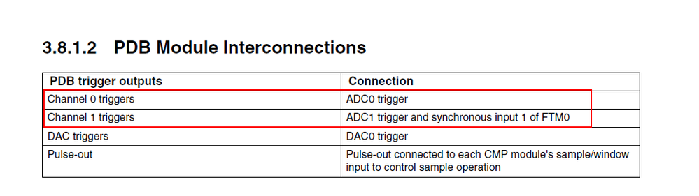

Hello Joon,

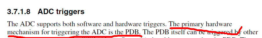

Hardware trigger ADC is use the PDB component ,
Hope it helps
