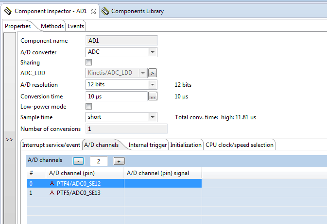

I'm testing the ADC component of FRDM-KE02Z and I've set the conversion time and channels as shown

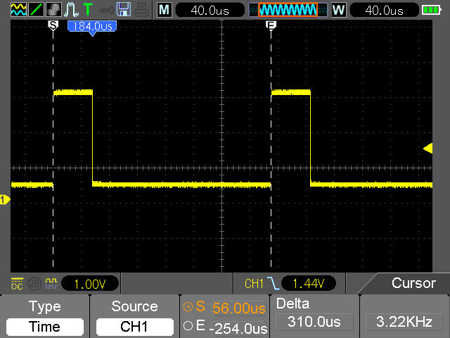

Finally here's the signal capture on the oscilloscope for checking the ISR process.
The sampling time and acquired values are okay but I expect an ADC process of 20us as I set 2 channels and a conversion time of 10us. Why I get more than 40us?

You were using the High Level Driver, if you use the Logical Level Driver (LLD) you will increase the performance. The LLD needs more configurations but requires less instructions to work. The image below shows how I configured the ADC_LLD.

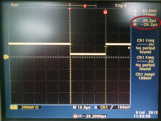

I made a similar project. I configured a pit with an interrupt every 312 us where I clear a GPIO and then I start one ADC conversion. When the ADC conversion finishes in another interrupt I set the GPIO and read the measured value. This takes 29.2 us. I have exactly the same configurations as you with PEx.
I repeated this process but configuring the ADC time conversion to only 2.5 us and I first started the ADC conversion and then set the GPIO. The result is that the pulse lasts ~10 us. My conclusion is that the ADC performance is not the better but is not as bad as we though because the GPIO toggle takes a lot of time.
Earl.

I'm sorry, I were wrong with my last assertion about the 3.5us of time conversion. In this case total ADC acquisition takes 56us (not 68us). However the problem persist and no matter how low is the conversion time. The total acquisition is always 56us (I've tested it with 2.5us, 5us and 10us with PE). I see that your setup is not exactly the same as mine. Note that:
  • I have not enabled the AD1_OnEnd interrupt
  • I've configured 2 ADC channels as shown in my first post (I supposse you've done the same)
  • I set the GPIO before start the ADC conversion and clear it after read the last ACD conversion, which involves the total ADC acquisition for the 2 channels. Both methods are placed into the Timer ISR.
Please, could you reproduce this setup?

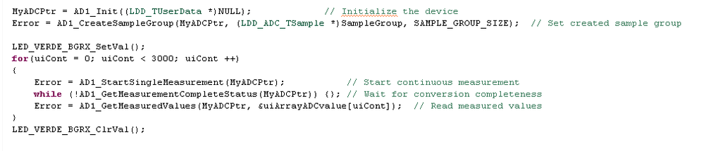

I am having almost the same problems as Gaston had. I am working with a FRDM-KL25Z and I need to make many ADC measurements very fast (every 2us) and I am not able to get so fast conversions.
I am a beginner with these micros, and I first started following a very good tutorial "ADC with the Freedom Board" by Erich Styger. I started with the component ADC and the same two methods as Gaston used in his project:
(void)AD1_Measure(TRUE);
(void)AD1_GetValue16(&value[0]);
But I was not able to get so fast conversions. So I tried with the component ADC_LDD and the trueth is that the conversion time was reduced significantly, but not as much as I need.

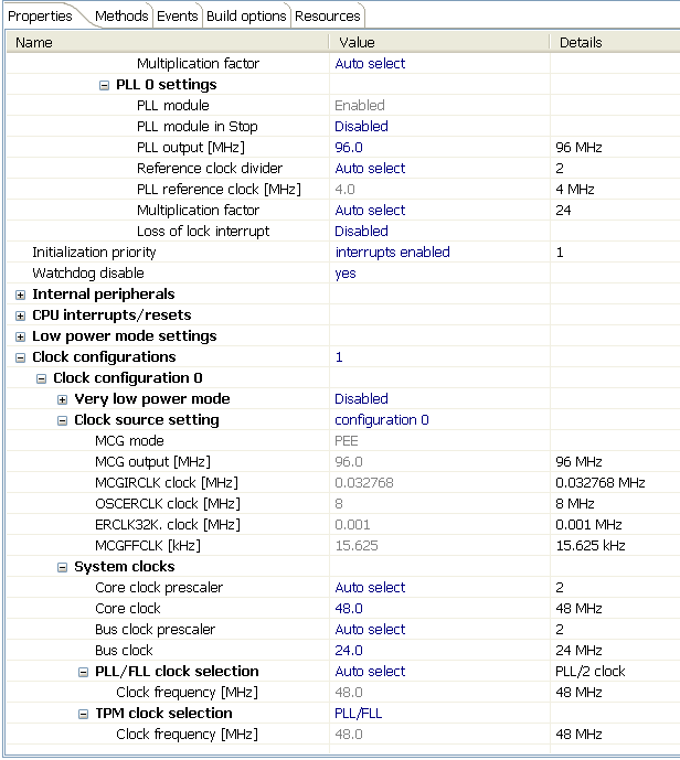

I only use one channel and I use the same methods of the ADC_LDD you explained to Gaston. Please find below the my clock configuration:
So, I make 3000 measurements and the results are stored in an array.
A led is switched on at the begining of the 3000 conversions and it is switched off at the end. Thanks to this led I could measure with the oscilloscope that the 3000
measurements take 24.1ms. So 8us per measurement (not fast enough because I need to drop to 2us).
1.- Is there any way to reduce the conversion time by changing any configuration of the clock?
2.- As you mentioned before, using DMA could be a solution. What I would need is to store automatically the result of the 3000 conversions by DMA. Am I right? Please correct me if I am wrong.
