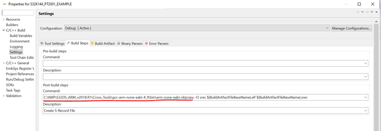

I have been struggling with the example code for the S32K144 to operate the PT2001. The example from your webpage seems to be outdated for the new version of S32 Design Studio.
This is the current version:
S32 Design Studio for ARM
Version: 2.2
Build id: 200116
These are the error codes shown:
make: *** No rule to make target 'S32K144_PT2001_EXAMPLE', needed by 'all'. Stop. S32K144_PT2001_EXAMPLE C/C++ Problem
Program "gcc" not found in PATH S32K144_PT2001_EXAMPLE [Discovery Options] page in project properties C/C++ Problem
Could someone help me with the right path or the right configuration for this product?
Thank you so much!
4,705 Views
Senlent
Hi@danielcorrea
1.orginal command path
C:\Freescale\S32_ARM_v1.2\Cross_Tools\gcc-arm-none-eabi-4_9\bin\arm-none-eabi-objcopy -O srec ${BuildArtifactFileBaseName}.elf ${BuildArtifactFileBaseName}.srec
2.Change the path.(below is mine,you should replace it )
C:\NXP\S32DS_ARM_v2018.R1\Cross_Tools\gcc-arm-none-eabi-4_9\bin\arm-none-eabi-objcopy -O srec ${BuildArtifactFileBaseName}.elf ${BuildArtifactFileBaseName}.srec

danielcorrea
Hello @Senlent thanks for your answer!
The example works now.
