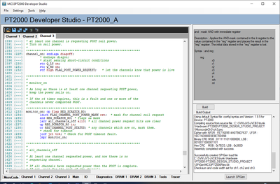

Here's the screen grab from developer studio.  0x23A is a jump relative command.

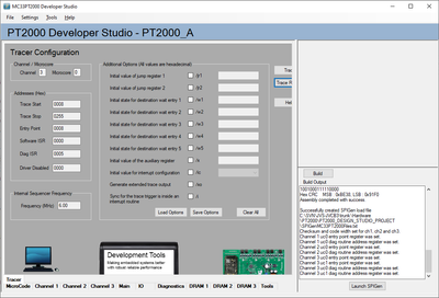

Am I having SI issues here, or is there a problem with my trace setup or the trace software?  Trace configuration is as shows.

Here is a shot of the trace configuration

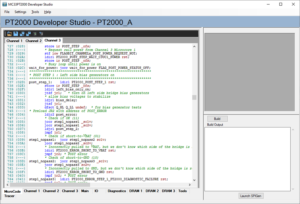

Code from 0x008 - 0x028:
code from 0x028 - 0x041 (note that the trace aborts at the jump at 0x038, and the previous step loaded the address into JR1 so the trace module shouldn't have any problem realizing that code is passing to post_step_2 @ 0x043

I noticed that in the previous post that tracing was set up for microcore 1.  Microcore 0 is the core which runs this code.  I reset the trace_config register for microcore 0 and reran the trace, but it seems nothing has changed (new trace results attached).

I'd also like to add, that this path.txt trace seems to be mostly incorrect, as there are subroutine calls at 0x10, 0x30, and 0x32 which are not showing up in the path.   The busy loop in 0x2C may or may not be taken as it is likely that the other channels start executing code earlier and the rail power may already be on.

  • It could be due to mis-alignment of tracer input to PT2000 inputs:
    • Check that the registers (tracer_start/stop/config/entrypoint/ISR_addresses) are configured in the PT2000 in the same way as the tracer configuration (this is the cause of 90% of the failure I had with the tracer L )
