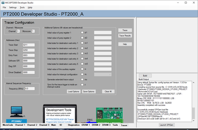

I am attempting to debug some PT2000 firmware that I wrote.  This is a prototype board using a PT2000 to drive some H-bridges.
When I attempt to capture a trace, the console that pops up shows the following messages.

Here's the screen grab from developer studio.  0x23A is a jump relative command.
The prototype PCB is using a 1.5" 50-ohm Z0 trace between the PT2000 and the BNC connector.  I'm using a 6" 50-ohm BNC cable to connect the trace module to the PCB.  I attempted to hook up an oscope to examine signal quality, but putting a T-connector and scope extension caused the trace module to error out on the first sample, unsurprisingly.
This issue is very repeatable.
I attempted to sample the debug cable to see if I had SI issues.  I used a 3' cable to a T-connector on the oscilloscope, then a 6" cable from the tee to the trace capture card.  The scope capture is attached. Based on the layout, it seems that the KITPSCEVM tracer module may not be terminated.
I attempted to put the oscope on the end of the bus (6" from prototype board to tee, (tee connected directly to trace module) and 3' from tee to oscope) and turn on 50-ohm termination on the oscope, but the trace module didn't even start a capture when I did that.
Am I having SI issues here, or is there a problem with my trace setup or the trace software?  Trace configuration is as shows.

Here is a shot of the trace configuration

I noticed that in the previous post that tracing was set up for microcore 1.  Microcore 0 is the core which runs this code.  I reset the trace_config register for microcore 0 and reran the trace, but it seems nothing has changed (new trace results attached).

        There could be a number of issues:
  • Does tracing fails (with a specific setup) all the time? Or only sometimes? If the answer is sometimes, it probably is a SI issues, otherwise we should look at the setup
  • It could be due to mis-alignment of tracer input to PT2000 inputs:
    • Check that the registers (tracer_start/stop/config/entrypoint/ISR_addresses) are configured in the PT2000 in the same way as the tracer configuration (this is the cause of 90% of the failure I had with the tracer L )
    • Code file supplied to the tracer is the same as the one downloaded in the PT2000? It should be in case SPIgen is used, but better check
    • There are multiple PT2000 on the board? Is the correct one being traced?
