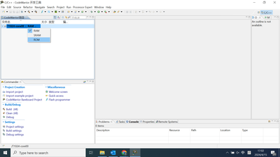

We can set the rom address and ram buffer address by setting the generate ROM image option in POWERPC LINKER. However, I found that there is no such setting option in the POWERPC AEABI E5500 LINKER setting options, and I want to know how to set up rom IMAGE in this compilation environment

Please refer to the screenshot to configure the project as ROM version.
