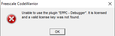

I have an MPC8358E chip set. I installed Code Warrior v8.8 on Windows 10 (64-bit, 8 GB RAM). After installation, when I opened Code Warrior, I was unable to debug. I downloaded a valid license for Code Warrior and replaced it, but the issue persists. I also tried reinstalling Code Warrior multiple times, but the problem remains the same.
Here I have attached the screenshot for your reference

The license file is invalid.
If you don't purchase CodeWarrior license, you could create an internal ticket from https://support.nxp.com/s/?language=en_US to require an evaluation license.
The put license.dat file in folder C:\Program Files (x86)\Freescale\CodeWarrior PA V8.8.

I downloaded the license.dat and replaced it with the active one, but the problem persists. I have tried reinstalling Code Warrior 8.8 multiple times, but the issue remains. I am now receiving an error during installation (see attached screenshot for reference).

Please ignore this installation error and continue to install Patch 8.8.6.
Because the latest CCS USB driver is included in Patch 8.8.6.
