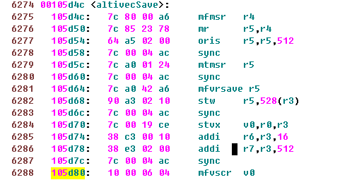

I build T2080 board and run error , bad opcode: 10000604, not implement this instruction, dissasmbled the elf find the instruction is mfvscr v0 (opcode : 10 00 06 04), but can't find in e500 instructions document, somebody known which document has this instruction implement ? thanks very much!
1,276 Views
alexander_yakov
Here is a direct link to the document you asking:
https://www.nxp.com/docs/en/reference-manual/ALTIVECPOWERISAPEM.pdf
