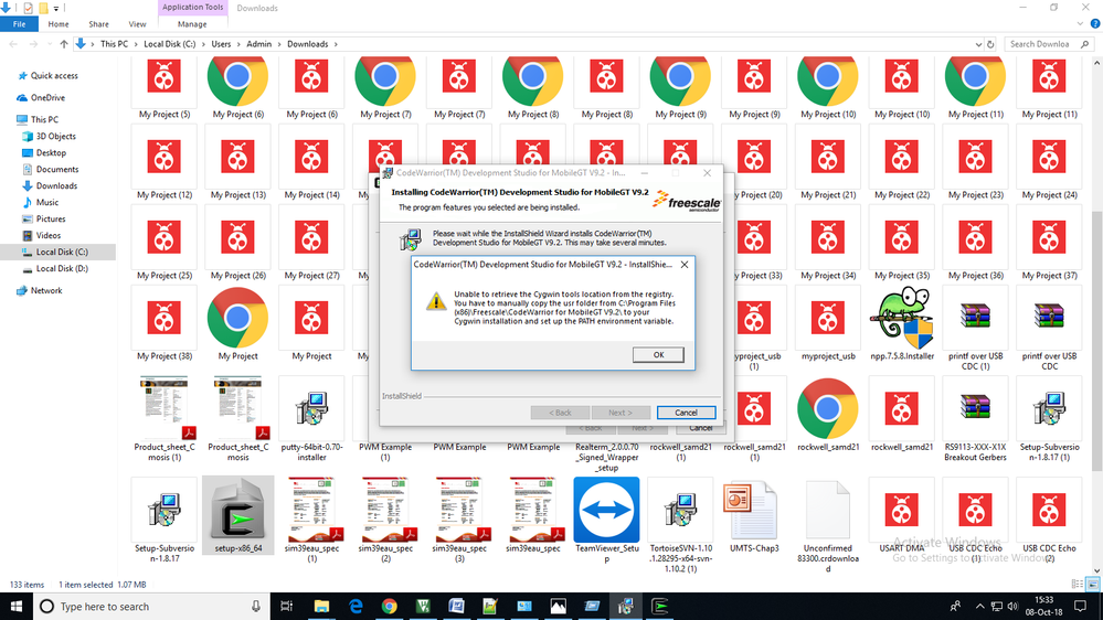

Hai,
We want to use the TWR MPC5125 tower module , Which version of the code warrior is compatible can you please suggest us .
Thank you
Maheshwar.
1,734 Views
maheshwarreddy
Hai ,Pavel Chubakov
Thank you for the reply . i installed the code warrior mobile gt 9.2 but while installing its giving the error .I continued but after opening the IDE if i create a project when i compiled that time it is error as below.
error unable to call the command line tool. check your path environmental variable.

Pavel
Use NXP CodeWarrior MGT 9.2 for the TWR-MPC5125:
https://www.nxp.com/products/processors-and-microcontrollers/power-architecture-processors/mpc5xxx-5...
This CodeWarrior supports CodeWarrior TAP and can be used under Windows 7, Windows 8 and Windows 10.
There is also Linux version of this CodeWarrior.
