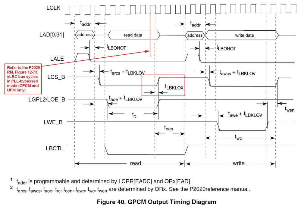

Please refer to the P2020 QorIQ Integrated Processor Hardware Specifications, 2.12.2.3 Local Bus AC Timing Specifications for PLL Bypass Mode:
https://www.nxp.com/webapp/Download?colCode=P2020EC&location=null
19,204件の閲覧回数
fmlgb
I have read the p2020ec, but I still haven't figured out the exact timing relationship between the sampling point of reading data and the reading signal. At the same time, the time when writing data becomes invalid is related to the accurate timing of writing signalGPCM.png.
Can you give me a further explanation on the attached figure?
Thank you.

P2020 QorIQ Integrated Processor Reference Manual, 12.4.1.7 PLL Bypass mode:
"In PLL bypass mode, eLBC drives new address, data, and control signals effectively on falling edges of LCLK, but continues to sample synchronous read data on rising edges of LCLK to maximize the set-up margin for reads."
In the P2020 QorIQ Integrated Processor Hardware Specifications, 2.12.2.3 Local Bus AC Timing Specifications for PLL Bypass Mode:
19,205件の閲覧回数
fmlgb
Thank you for your reply.
According to your description, the sampling point for reading data should be the rising edge of lclk before the LOE is invalid, and at the next falling edge of lclk, LOE becomes invalid. Is my description right?
In addition, how about write timing?
19,205件の閲覧回数
ufedor
Yes.
Please refer to the Figure 40 in the P2020 QorIQ Integrated Processor Hardware Specifications, 2.12.2.3 Local Bus AC Timing Specifications for PLL Bypass Mode.

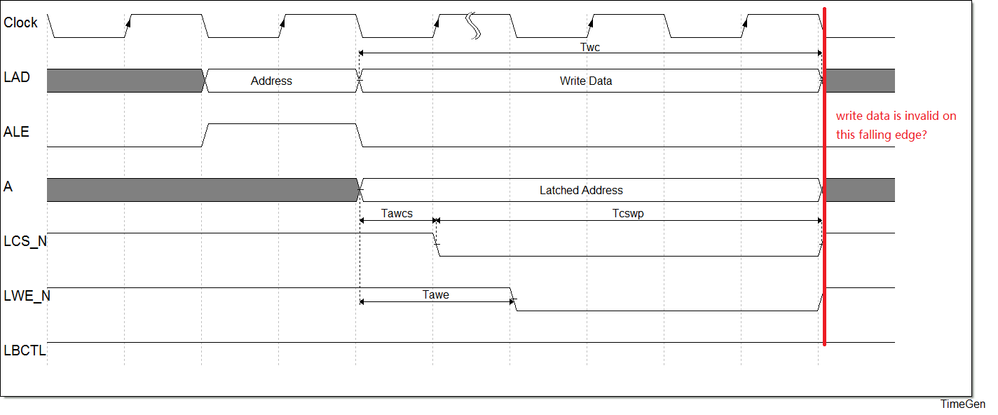

According to the above description, I have drawn the following timing diagram:
Is my description and timing diagram right?

You need to use timing data from the  corresponding row of the "Table 12-191. GPCM write control signal timing" without any modification.

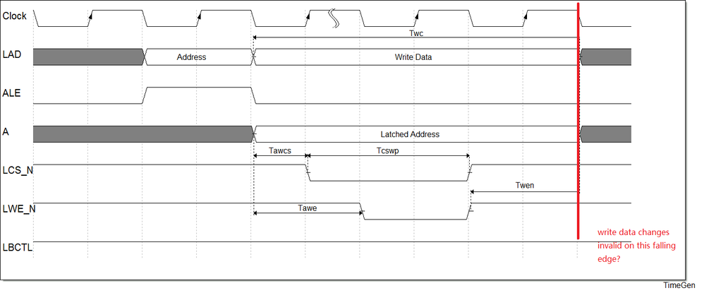

According to your help and my understanding of the P2020RM, I think the reading and writing sequence is as follows:
PLL bypass read timing:
The sampling point for reading data should be the rising edge of lclk before the LOE/LCS is invalid. This time is determined by the parameter tCSRP.
PLL bypass write timing:
Write data is invalid at the end of the tWC. This time is determined by the parameter tWC.
Is my understanding right?
I have another question:
As described in P2020RM, LCSn (only if ACS is not equal to 00) and LWE signals are negated one cycle earlier during Writes when TRLX is 1.
The write sequence will change from Figure 1 to figure 2?
                                                                                Figure 1
                                                                                  Figure 2

fmlgb
If I use timing data from the  corresponding row of the "Table 12-191. GPCM write control signal timing" without any modification.
TRLX
XACS
ACS
CSNT
tAWCS
tCSWP
tAWE
tWEN
tWC
1
0
11
1
1.5
1.25+2* SCY
2
0
2.75++2* SCY
Write timing diagram as following:
If it is the above timing, write data and write signal are invalid at the same time. so the hold time of write data will be insufficient.
And according to your comment, I am confused about the following description in P2020RM:
TRLX is 1:
Relaxed timing on the following parameters:
• Adds an additional cycle between the address and control signals (only if ACS is not equal to
00).
• Doubles the number of wait states specified by SCY, providing up to 30 wait states.
• Works in conjunction with EHTR to extend hold time on read accesses.
• LCSn (only if ACS is not equal to 00) and LWE signals are negated one cycle earlier during
Writes
19,210件の閲覧回数
fmlgb
If Twen = 0, is writing data and writing signal invalid at the same time?
