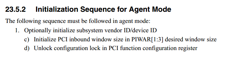

Dear everyone,
     I want to use MPC8309 as the pcislave in uboot,i see
but i dont know configure which register.please give me some advises.

Vendor ID and device ID registers are described in Sections 23.3.3.1 and 23.3.3.1 of MPC8309 Reference Manual.
PIWARn registers - Section 23.3.2.14
PCI function configuration register - Section 23.3.3.24
Alexander
