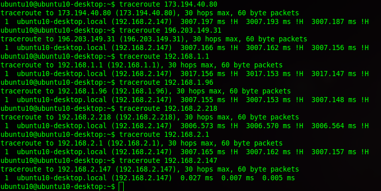

the figures below describe the MPC8308NSG (called NSG-EBSYS) traceroute result and the host addressed 192.168.2.147 one.
Zied

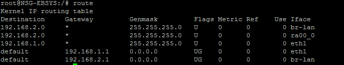

Please show kernel routing table in NSG

ziedjelassi

alexander_yakov
Routing table shows two networks 192.168.1.0 and 192.168.2.0 directly connected, network 192.168.2.0 listed two times with interfaces br-lan and ra00_0
So, as I can guess, you have configured IP addresses from the same network 192.168.2.0/24 on two different interfaces.
Please determine which one is correct, remove incorrect interface (or assign IP-address from another network).
Check the result by ping 192.168.2.147
Also, there are two "default" entries. This entry means where to send packets for all other networks, not listed explicitly in routing table.
In your case first entry is correct, NSG should send all other packets to 192.168.1.1 (your ISP router modem). Second entry should be removed.
Check the result by traceroute to any external internet address.

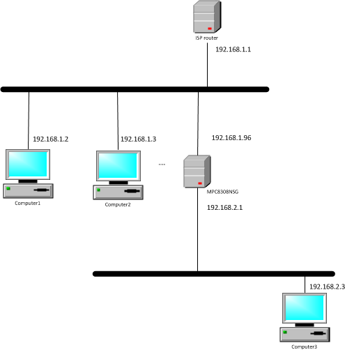

Hi Sinan,
Thx for your answer.
the linked figure shows our network.
the next table resumes the ping results.
Ping                        from                          To                               Status
                    192.168.2.3                    192.168.2.1                  ok
                    192.168.2.3                    192.168.1.96                ok
                    192.168.2.1                    192.168.2.3                  ok
                    192.168.1.96                  192.168.1.1                  ok
                    192.168.1.96                  192.168.1.3                  ok
                    192.168.1.96                   www.freescale.com      ok
                    192.168.2.3                    192.168.1.1                  NOK
                    192.168.2.3                    192.168.1.3                  NOK
                    192.168.2.3                    www.freescale.com       NOK
Zied.

sinanakman
Senior Contributor III
Hi Zied, it seems like your 8308 is not doing the forward. If you are running Linux on that box, you might try something like :
echo 1 > /proc/sys/net/ipv4/ip_forward
To enable ip forwarding. Check its value beforehand if it was disabled.
