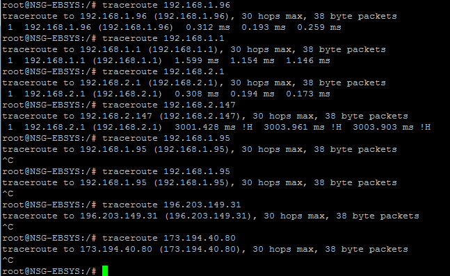

the figures below describe the MPC8308NSG (called NSG-EBSYS) traceroute result and the host addressed 192.168.2.147 one.
Zied

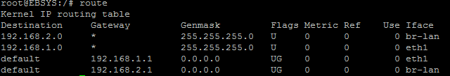

Please show kernel routing table in NSG
15,552 Views
ziedjelassi
15,552 Views
alexander_yakov
Routing table shows two networks 192.168.1.0 and 192.168.2.0 directly connected, network 192.168.2.0 listed two times with interfaces br-lan and ra00_0
So, as I can guess, you have configured IP addresses from the same network 192.168.2.0/24 on two different interfaces.
Please determine which one is correct, remove incorrect interface (or assign IP-address from another network).
Check the result by ping 192.168.2.147
Also, there are two "default" entries. This entry means where to send packets for all other networks, not listed explicitly in routing table.
In your case first entry is correct, NSG should send all other packets to 192.168.1.1 (your ISP router modem). Second entry should be removed.
Check the result by traceroute to any external internet address.

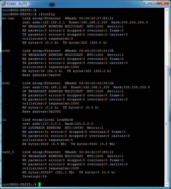

Hi Alexander,
the linked figure shows the MPC8308NSG ifconfig result:
the routing table presented below is the auto generated one.
Zied.
15,551 Views
alexander_yakov
If this case please show source file from which this routing table was auto generated.
It can not be auto generated from ifconfig output.
