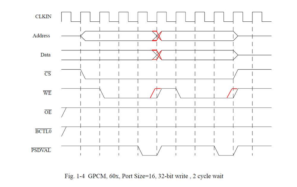

Nevertheless, what I am really looking for in the timing diagram is how how WEn behaves when the CSNT bit is set. (CSNT bit from the ORx (options register of GPCM))
CSNT = 1 deasserts the WEn a quarter clock cycle before the CSn (deassertion) providing additional hold time.
But since the CSn remains LOW for multiple 64 bit transactions, what timing does the WEn follow.
Does the WEn get deasserted quarter clock cycle before the rising edge of CLK for every 64 bit transaction (or)
Does it do that only for the last transaction before the CSn gets deasserted?

Bulat
Normally there is no such a term as "... multiple 64 bit transactions (apart from the cache reads/writes)", only single-beat 64 bit (or 8-bit/16-bit/32-bit) transaction and 32-byte burst (that is four 64-bit beats). "Normally" means BCR[ETM]=0. If BCR[ETM]=1, then the CPM (not the core) is able to use also 16-byte and 24-byte transactions.
Your understanding of CSNT behavior is not correct. If CSNT=1, WEn is deasserted  1/4 clock cycle before Address/Data Invalid, not "a quarter clock cycle before the CSn (deassertion)". This in particular means that CS does not have to be deasserted during backto-back GPCM read/write cycles. Please see table 11-31 of the Ref Manaul for details. Figure 11-44 shows this case.
I have edited a figure 1-4 from the AN2176 to illustrate CSNT=1 case, see picture. If your logic analyzer had better resolution, you would see this kind of WE timing.
