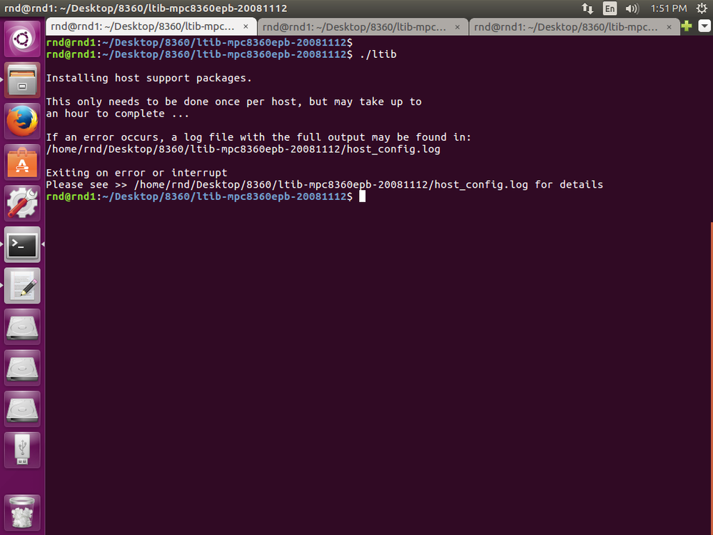

narreddiprakash
            I am using MPC8360EA-MDS-PB board and I am using a PC loaded with ubuntu 8.10. I previously installed ltib for MPC8323E-RDB successfully and I worked over it well. Now I removed the previous installed LTIB and trying to install it for MPC8360EA-MDS-PB board, but it is giving following problems..
rnd@rnd2:~/Desktop/8360/ltib-mpc8360epb-20081112$
rnd@rnd2:~/Desktop/8360/ltib-mpc8360epb-20081112$ tail -f host_config.log
Died at ./ltib line 1193.
Started: Mon Apr 24 12:24:05 2017
Ended: Mon Apr 24 12:24:06 2017
Elapsed: 1 seconds
These packages failed to build:
flex
Build Failed
Started: Mon Apr 24 12:26:49 2017
Ended: Mon Apr 24 12:26:50 2017
Elapsed: 1 seconds
fake-provides
Build Failed
I solved this by using patches provided in nxp community.
but this time LTIB stopped without any error / warnings as follows..
main:542
Started: Mon Apr 24 12:28:24 2017
Ended: Mon Apr 24 12:28:25 2017
Elapsed: 1 seconds
Build Failed
What might be the problem here.? Is it with the PC what I mentioned above.? which version of Ubuntu supports LTIB building for MPC8360EA-MDS-PB bsp board.? I downloaded this BSP from nxp website
Prakash

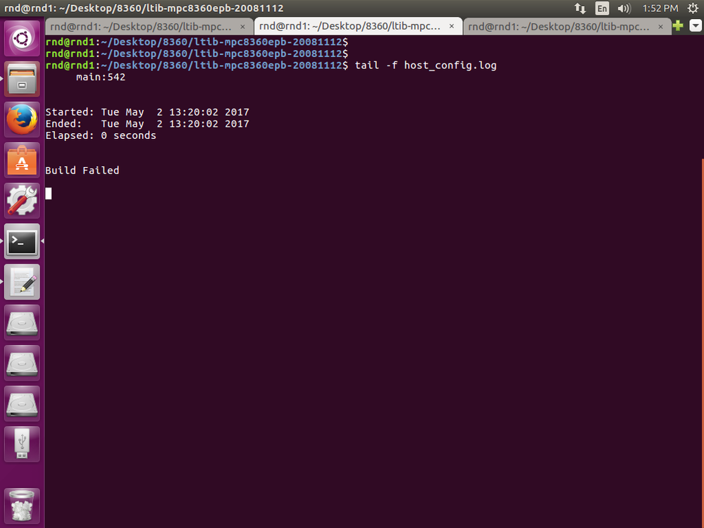

narreddiprakash
Sir,
      Thanks for your support, but still I am facing same issue, but again I started to build LTIB in a new PC with ubuntu 9.04, where I observe that the the building is failed at Flex package(Even flex installed in Host PC) and the log is as follows..
Started: Mon May 08 17:30:34 2017
Ended:   Mon May 08 17:30:35 2017
Elapsed: 1 seconds
flex
Build Failed
After this I ran following command...
./glibzlib.sh  /home/rnd4/Desktop/8360/<Ltib_Folder>/
./rpmdb.sh  /home/rnd4/Desktop/8360/<Ltib_Folder>/
then building is failed without error and the log is as follows..
main:542
Started: Mon May 08 17:38:24 2017
Ended: Mon May 08 17:38:25 2017
Elapsed: 1 seconds
Build Failed
7,133 Views

2.png1.pngThe response of the ./ltib in LTIB installation is in the attached images. Please look at them and respond with possible solution to solve the issue.
Prakash

Pavel
Ubuntu 8 is too old.
Use Ubuntu 14 32bit.
Usually the following command sequence is used.
  1. Install Ubuntu 14 32-bit.
  2. sudo apt-get install autoconf automake libtool gettext xorg-dev patch g++ rpm zlib1g-dev m4 bison libncurses5-dev libglib2.0-dev gettext build-essential tcl intltool libxml2-dev liborbit2-dev libx11-dev ccache flex uuid-dev liblzo2-dev
  3. Create folder and enable permission for this folder using chmod command (enable reading and writing).
This folder will be used for LTIB installing.
  1. Mount .iso image
  1. Start installing using .install command
Usually "/usr/sbin/visudo" command is needed
For example:
sudo /usr/sbin/visudo
pavel ALL = NOPASSWD: /usr/bin/rpm, /opt/freescale/ltib/usr/bin/rpm
Pavel Chubakov

narreddiprakash
I tried with ubuntu 14.04 but I am getting same issue there. Ubuntu 8.10 is working well for MPC8323E-RDB board. /usr/sbin/visudo is updated as follows as per requirement.
rnd ALL = NOPASSWD: /usr/bin/rpm, /opt/freescale/ltib/usr/bin/rpm
Still it is giving issue. I may suspect something if any errors come, but it is exiting without any errors as follows..
main:542
Elapsed: 1 seconds
Build Failed
Is it problem with ltib file or any other.?  Please suggest different method to solve this issue.
Prakash
