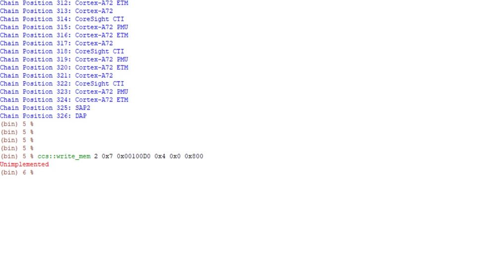

jhkim2
Thanks for reply.
I put the CW command "ccs::config_chain {ls2085a sap2}" and set "ccs::write_mem 2 0x7 0x001000D0 0x4 0x0 0x800" in order to set the board enter RSP for secure boot test.
But "unimplemented " message returned and I cannot go further.
7,159件の閲覧回数
ufedor
Please provide complete ccs log as textual attachment - top a picture.
