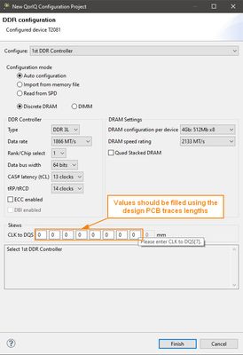

ufedor
1) Use the DDR Wizard:

7,522 Views
Irfan3
Hi ufedor,
Thanks a lot for spending your valuable time in answering my queries.
1. According to this image I see the data rate at controller side and speed rating at dram settings are different. Any reason for that. And for the skews can you please give me a hint on how to get it as I don't have knowledge of hardware PCBs
3. I tried on custom board as well as t2080rdb both were not supporting and were throwing error as "d_init not cleared. Memory may not work". So there is a confusion as to what value to take in rcw to obtain 1866mt/s data rate.
Thanks and regards
Irfan
7,482 Views
ufedor
No special reason - just a possible case.
For the discrete SDRAM memory the information about DDR interface signals PCB traces lengths has to be provided by the board designer.

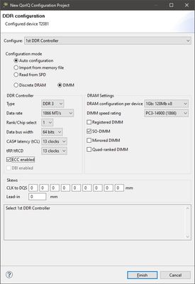

ufedor
The following Wizard settings should be used for the T2080RDB board:
