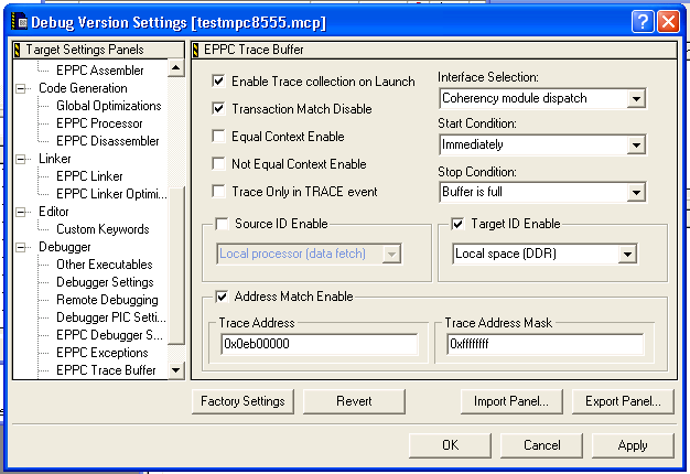

Hi Pavel,
we were able to locate the document and see the trace buffer  in action.
We were unable to find the right settings to trace a write over PCI/and through the Core to a DDR location (0x0eb00000) .
We tried using the following settings -
Do you see something which we overlooked, or did wrong?
Thanks in advance.
2,027 Views
LPP
It's good but i suggest to set "trace only in TRACE event" flag.
Pavel
2,027 Views
dijo
Thanks again, Pavel!
Yes it works!
Would be great if you could tell how it works.What the "TRACE" implies?
