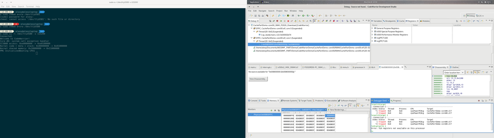

alexy_torres-au
Here is the screenshot, you can also find information about the LAW in the upper right corner.Screenshot from 2020-02-21 20-57-03.png
4,288 Views
ufedor
Please provide screenshot for the code at physical address 0x00800FFC.
4,288 Views
alexy_torres-au
Sorry I didnt see the address on the screenshot was 0xFFFFFFFC
Here is a screenshot at 0x00800FFC (physical):

ufedor
ba 0x800000
This is your problem.
You have to use relative addressing - not absolute.
4,288 Views
alexy_torres-au
Definitely my problem. It works with a relative branch.
