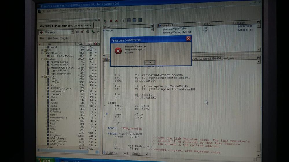

Hi all,
I am using 32-bit NOR flash as Boot flash for the MPC8358E processor. were I have configured RCWHR as 32-bit Boot [0x00700004] .and also chip select 0 configured as 32 bit. in Debug mode it's working fine. but I am facing a problem with the ROM version mode. I am getting a program exception error  (0x0700) while running the code.
can anyone explain the following init .asm code
lis r3, gInterruptVectorTable@h
ori r3, r3, gInterruptVectorTable@l
sub r3,r3,0x0004
lis r4, gInterruptVectorTableEnd@h
ori r4, r4, gInterruptVectorTableEnd@l
lis r5, 0xFFFF
ori r5,r5,0xFFFC
loop:
lwzu r6, 4(r3)
stwu r6, 4(r5)
cmpw r3,r4
blt loop
blr
#endif //ROM_version
Venkat
2,503 Views
venkat1
errorerrorWhat could be the reason behind while running the same code, automatically it's breaking from the loop After 10cycle and getting Program exception 0x0700 error...
I have basic doubt, can we use 32-bit NOR flash as Boot flash.?

Did you program the ROM version bin image in NOR flash?
Do you have a NXP demo board to verify your procedure?
Please check whether there is problem to read and write NOR flash.
Please dump the content in NOR flash in CodeWarrior IDE from Debug->EPPC->Load/Save Memory, then compare the dumped  file with the original bin file.
You could use "hexdump" command in Linux to dump these binary file and use "diff" command to check whether they are the same.

The above code is used to copy the exception vectors from ROM to RAM.
