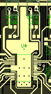

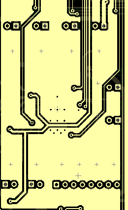

I have to switch 3 heater elements of each 800mA 24V (19W). After a few minutes via PWM I will reduce the current to about 400mA (50% duty cycle at 200Hz) and this will stay like that.
With an RDS ON of 0.55ohm we have about 0.352W power dissipation for each output. So in total 1.056W for a few minutes (0.352W x 3). (0.088W x 3 = 0.264W after a few minutes)
On the other outputs I will have a current of <= 200mA.  0.022W power dissipation maximum for each output -> so for the other 13 outputs maximum 0.286W when they are all ON with 200mA -> in reality only a few outputs of the 13 outputs will be used at the same time and most of the output currents will be <= 100mA.
Can I do this?
The maximum power dissipation of the IC is 1.7W without heat sink. So normally I think it should be okay.
The IC is mounted on a 2 layer PCB. At the top side the ground surface under the IC is about 200mm2 and via 12 via's the top ground surface is connected to the bottom layer with a ground surface of > 400mm2.
Top layer                                             Bottom layer

I think you can do that,try it!
