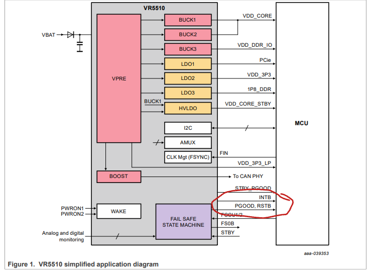

Hi all,
       Recently,i am trying to make the VR5510 and S32G exit the Standby mode. After entering the standby mode successfully, I pull up the PMIC_STBY_MODE_B to let the PMIC exit standby mode. Then the PMIC will pull down PGOOD, and this will reset the whole S32G.
   Is this phenomenon correct? If the PMIC pull down the PGOOD after existing from standby mode, how can S32G use fast boot when exit standby mode?

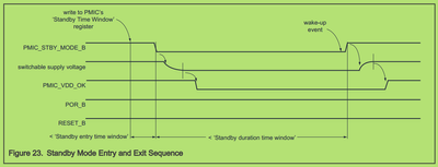

brian_w
From the G2 datasheet, when existing from standby, POR_B and RESET_B should remain high. How can we achieve this? Are there some configurations in VR5510 to achieve this?

KalaimaniArumugamdev
Hi @brian_w
       There is chance the Reset and PGOOD  are sharing  in the same  pin. Because of this block diagram,
4,473 Views
brian_w
When the PMIC exist from standby, the RESET_B must will be pulled low, and the RESET_B is shareing with POR_B, so the POR_B will be pulled low too. Is this what you mean?
