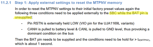

realin
芯片第一次MTP重新编程,将0X73=0X08,0X74=0X08,ok之后,欲恢复出厂设置,将RESET=0,CANL=0,CANH=VBAT,VBAT重新上电,芯片不能恢复出厂设置,请帮忙分析一下原因

使用的EVB单板为UJA1169AF3_EVB

JozefKozon
Dear Realin,
please make sure the BAT pin is unsupplied when you are trying to factory reset the UJA1169A.
Please check and share the content of the WRCNTS bit in the MTPNV status register. To confirm that the SBC registers were not restored.
