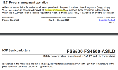

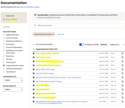

3)is there any fault which will shut off regulator? in this case, MCU will not work.
[A] We have FMEDA (Failure Mode Effects and Diagnostic Analysis) reports describing detailly impacts of the faults. Please download the documents from the FS65 product page, under the Secure section. Please also check the Safety Analysis Report.
High temperature fault will shutdown individual regulators.
