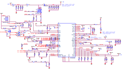

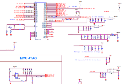

Hi Team,
I am having difficulties setting up the S32K344 + FS26 (MFS2613AMDA2AD) combination. The HW design is EVB based (so I can discard issues with the HW setup)
MCU Part No : S32K344EHT1VPBST (IC MCU 32BIT 4MB FLASH 172QFP)
PMIC Part No : MFS2613AMDA2AD
My problem is that, PMIC all voltage outputs not stable.
Schematic followed as per EVB (S32K3X4EVB-T172)
Please let me know the issue.
Thanks.
Gopala
1 返信
396件の閲覧回数
guoweisun
Do yo mean you refer to our EVB for schematic design,right?
If so can you test some waveform about VBAT(input voltage)/Vpre/VPRE_SW with load 300mA.
