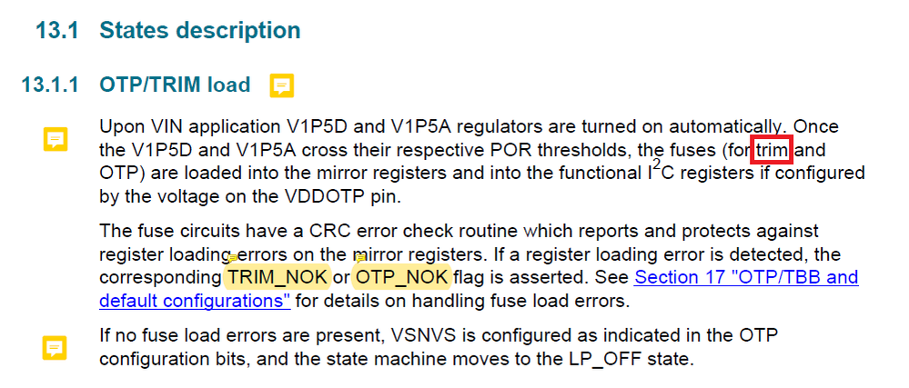

I am confused by the following description on page 15, datasheet of PF8100/PF8200.
1.What is the "trim"? What is the relationship between trim with OTP?
2.How to understand “fuse”?Does “fuse” refer to the parameter to be written into the register ?
2.What is the mirror register?What is the relationship between mirror egister with I2C register?

1: trim means change/update/modify OTP register content.
2: You can understand fuse as box,you can put your desired content into box for PMIC configuration.
3:OTP mirror register please refer to datasheet page98- 16.2 PF8200 OTP mirror register map (page 1)
