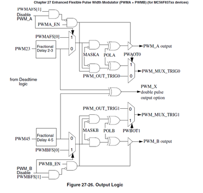

PWM23(Output polarity Inverted) channel masked,PWM23 output 1.Can PWM23 output 0?
Can PWM23 output 0 ( PWM23 Output polarity Inverted & channel masked )?
And what should I do ?
Thanks.
3,358 Views
xiangjun_rong
Pls refer to the above figure, in default, the POLA bit is cleared, in the case, if you set the MASK bit, PWM_A output signal will be logic 0.
If the POLA is set, in the case, if you set the MASK bit, PWM_A output signal will be logic 1.
The only way I think is that you clear the IPOL bit before you set mask bit so that the PWM_A output signal will be logic 0 after masking.
Hope it can help you
XiangJun Rong

547351265
3,370 Views
547351265
Thanks for your advice .
when set  PWM1A  Output polarity Inverted:
PWMA->SM1OCTRL |=0X0400; // PWM1A  Output polarity Inverted
We write the MASK register to mask the PWM signals .
The PWM1A output always high ( 1 logic ).

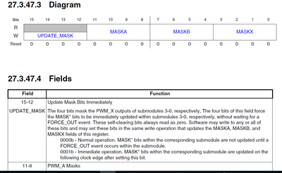

xiangjun_rong
Hi, Zhang,
Of course, you can write the MASK register to mask the PWM signals. If you want to update the PWM signals immediately after you write, pls set the corresponding UPDATE_MASK bit, then write the corresponding MASKA, MASKB or MASKX, the corresponding PWMA_xA, PWMA_xB, PWMA_xX will update immediately.
XiangJun Rong
