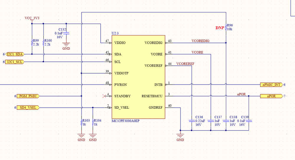

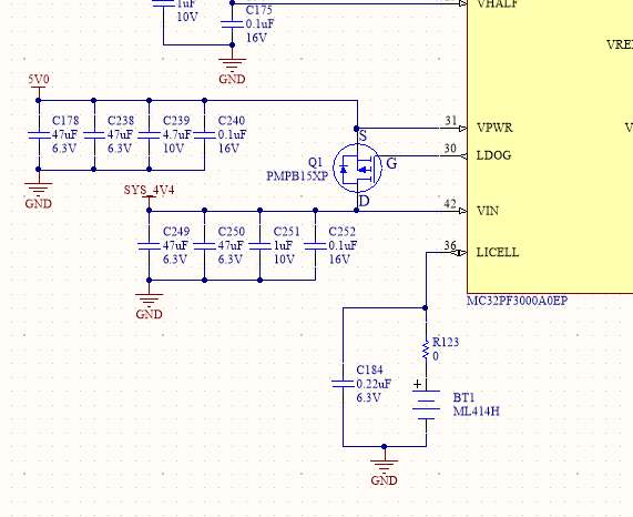

I have a 5V implementation with the PF3000 PMIC.  I previously used the chip on a different design but with 4V input.  Now with 5V input, I am using an external FET and LDO controller to generate the VIN from my 5V.  I am getting only 2.8v on VIN.  It appears if the LDOG gate signal is also at 5V, so FET is not ON?  Is there any setup of the PF3000 that needs to be done to enable the LDO circuit to generate the proper gate signal to the external FET?  Any other ideas why I have no FET gate drive?

Do you mind to show your schematic?
The STANDBY line has been tied to GND, but device continues to be in STANDBY.  Also, the rechargeable battery has been removed and replaced with a 3V input, generated from the VPWR 5V rail with a resistive voltage divider.

guoweisun
1: For more Standby mode setting details information refer to  datasheet page55/95.
2: Remove battery and also remove 3V resistors divider on VPWR to try.

I believe the device is stuck in STANDBY.  The STANDBY pin is tied low via a wire jumper between pin 4 and 5 of the PF3000 (pin 5 is the ICTEST pin).  I pre-programmed the PF3000, but there is no OTP setting for the STANDBYINV bit, so qith STANDBY tied low, the device should NOT be in STANDBY.  It appears the STBY_LOWPOWER_B is not really applicable.
The 3V resistor divider was provided as an input to the LICELL pin in stead of the battery.  I have tried this with a battery, open circuit, or tied to 3V on the LICELL input.
VPWR is tied to the 5V rail.

guoweisun
What are you set about STANDBYINV and STBY_LOWPOWER_B in your application?
If you don't know you can try to read them out by IIC?
