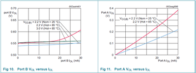

Do you have graphs showing the 5V Vol data from Figure 10 and Figure 11?yuji0935_0-1737420135188.png

I will use Vcc5V. The pull-up resistor is 1.5kΩ. I will use it at about 3mA. In that case, how many volts will Vol drop to?

No more data for reference according your test condition,suggest you do simulation by using IBIS model:
PCA9617A | NXP Semiconductors

Unfortunately there is no such parameter for reference here.
