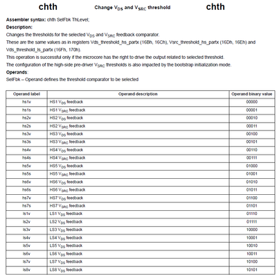

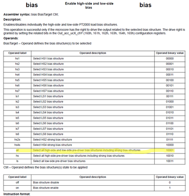

JozefKozon
Hello YM S,
please enable the bias for all channels.
And please try to change the monitoring thresholds.
If this will not help, I will need to contact an application team for advice. They always require following data. Please provide.
