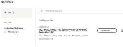

We have an FRDM33771CSPEVBS32K144EVB MCU board and BATT-14CEMULATOR. Please consider this EVBs for evaluation of the MC33771C. Please refer to the UM11402 attached.
We have a GUI (Graphic User Interface), which can be used for easy evaluation of the mentioned EVBs.
