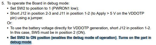

Hi everyone,
I'm currently having a similar issue. I have the KITVR5510XA0EVM and I have followed the instructions in section 8.1 of the user guide for this evaluation board. So, I have generated a script leaving default options, I have put the device in debug mode (I have tried both methods included in the guide of entering debug mode), checked that it was in debug mode and that I had high voltage at VDDOTP pin of the VR5510, moved to test mode and then run the script in the script section which did not return any error, just a list of OK Write Register information. Afterwards, I have removed the jumper to exit debug mode. However, the DBG_MODE in FS_STATES still shows that debug mode is active. Writing DBG_EXIT does not solve the situation. The VBOS output is 1.3 V (instead of 5 V) and the VPRE output is 1.4 V (instead of 3.3 V). The rest of the converters are not providing any output. The RED leds for PGOOD, RSTB and FS0B are still on.

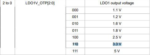

我重启了一下已经解决了上面的问题了,我已经成功编程了OTP,板子已经有输出了。但是我想问,我OTP给LDO1输出了1.8V,如果我想让它输出3.3V,那我可以通过进入DUBUG/TEST MODE去改变它的电压吗。还有一个问题是我进入DEBUG后,我把PWRON1关掉了,当我SCRIPT结束后,EXIT DEBUG后,需要把PWRON1重新打开吗?

TomasVaverka
Hi Miao,
For LDO1 output voltage of 3.3V, set LDO1V_OTP[2:0] = 0b110.

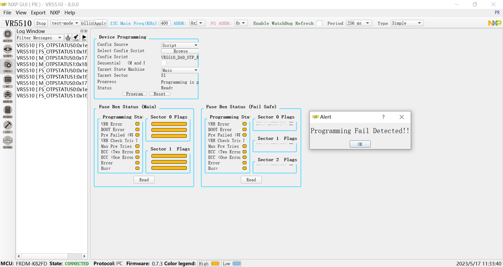

Oliver2
HI Tomas,
I have set it according to the manual and entered TEST MODE, and then generated an OTP file. Why does it report a programming error and what is the reason for this
