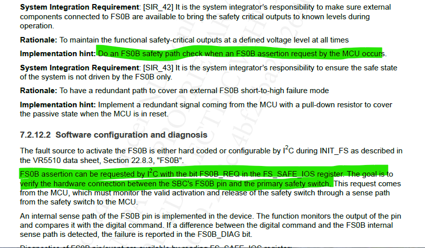

Issue: VR5510 request FS0B assertion by FS_SAFE_IOS register
1,125 Views
Yang_C
I am trying to assert FS0B by writing FS_SAFE_IOS register FS0B_REQ bit. Before doing so, VR5510 has been initialised sucessfully, watchdog is disabled and FS0B is released. Then I use I2C command to write FS0B_REQ to 1, however FS0B is not asserted(still high).
Wondering is there any extra configuration before write this register? The IDE I am using is S32DS3.5.10, LLCE1.0.7, RTD4.0.2.
Looking forward to your reply, thank you.
Kind regards,
Yang

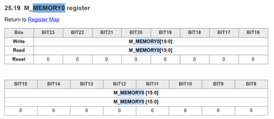

Yang_C
Hi Erika,
I did more tests today, realizing I can only read register(Main-0x20, Safety-0x21) correctly. When I tried to write a register and read its value back, the value is not changed. Not sure what happend.
For example,  I read M_SM_CTRL1 register, changed the TIMER_STBY_WINDOW[3:0], then read back the register, nothing changed.
Any suggestion?
1,000 Views
ErikaC
If watchdog can be disabled and FS0B release command can be write successfully by I2C to release the FS0B on their board,  I think writing register function is OK on your board.
Can you try to write a value to M_MEMORY0 register and read back the value to check if the change can be successful.
What is the full part number you is using ?

Yang_C
Hi Erika,
Issue is resolved. My mistake,  I found I didn't send CRC byte when writing the register.
Thanks for your support.

Hi Erika,
Thanks for your reply.
I have already successfully released the FS0B, my issue is I can't do a safety path check by asserting FS0B after VR5510's initialization.
Per VR5510 datasheet, by setting FS_SAFETY_IOS register FS0B_REQ bit to 1, MCU can request a FS0B assertion. I did so, also used oscilloscope to capture FS0B, always high after release. I checked the I2C communication, it works well since I can read the VR5510 deviceID correctly.
Is there any other steps I missed to assert FS0B before sending I2C command?
