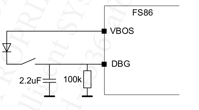

hi,
When the FS86 enters DEBUG mode through the DBG pin, can it skip the FS_INIT state without refreshing the watchdog?
At this time, the state of the FS0B pin and the RSTB pin is high or low.
thank you.

No you can't do that,FS_INIT state can't be skipped.

According to the connection method in the figure, connect the DBG pin to VBOS through a diode to enter the debug mode. Can FS86 work normally at this time? Does the watchdog need to be refreshed in this mode to skip the INIT_FS state machine?屏幕截图 2022-10-17 100722.png屏幕截图 2022-10-17 100722.png

Hello
A little bit support
(VDBG = VBOS – Vd ≈ 4.5V) Entry the debug mode.
 The DEBUG mode disables the Watchdog, lock FS0B low.
In the InitFSstate, you cannot use the watchdog, and release the safety path pin FS0b.
If you want to use the device, you should switch it to NORMAL_FS where you need to refresh watchdog, exit debug mode, and release FS0b pin
