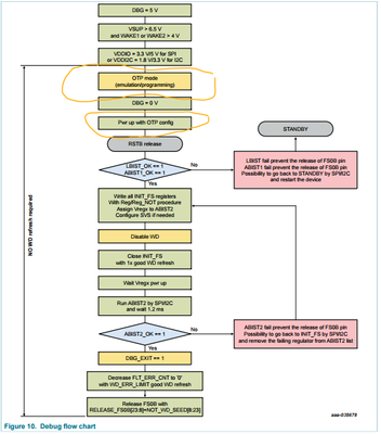

as far as I understand the FS85 data sheet, in debug mode the FS85 will not turn on its regulators.
I guess if you use the KITFS85SKTEVM you can create a dummy OTP config and work with that (turning on the regulators).
However, if the FS85 is in a custom circuit, is there a way to just turn it on with its OTP configured regulator voltages? No watchdog or soever?
This would be very helpful for the board bring-up.

You can see below debug flow chart, in debug mode if you do the OTP or emulation to turn on regulators, then regulators will power up according OTP/emulation configuration :

Thanks for clearing that up @guoweisun
Apparently we didn't do the right steps for debug mode. But now it works!
