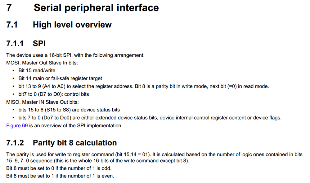

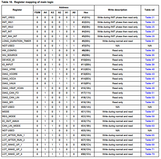

some registers of FS6500  can only be configured in the initial phase; some can be configured in normal mode;
please see the picture below about the SPI:
for more details, please refer to the datasheet of FS4500~FS6500 in the https://www.nxp.com/webapp/sps/download/mod_download.jsp?colCode=FS6500-FS4500&appType=moderatedWith...

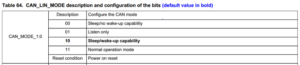

I would like to just elaborate my question..
Previously i was working with NXP evaluation board and used FlexCAN0 in MPC5744P. The CAN transceiver used in that board was MC33901. It's a standalone CAN transceiver. CAN communication was working good enough.
Now instead of MC33901, i used FS6500 and made the CAN interface connections as depicted in the application note. But the CAN communication is not working.
My question is... Should i need to configure any of the registers in the FS6500 through SPI before starting the CAN communication?
I just only want to have CAN communication. I am not interested in any of the safety related features right now.
5,839 Views
AllanAn
Hi Murugesh,
    OK, got it , you should configure CAN_LIN_MODE register, configure CAN_MODE_1:0 to "11",
the default CAN state is sleep;
    if the problem is still exist please check DIAG_VSUP_VCAN and DIAG_CAN_FD registers to find if there are CAN power supply and physical connection errors.

I am trying to write the FS6500 registers. But it is unsuccessful.
I want to know about the SPI wave format to be used..
1. Classical SPI or Modified SPI transfer format?
2. About the Clock polarity and phases?
