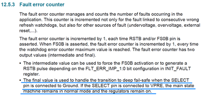

It is a reset due to watchdog. What I observe currently is, after the INIT_FS state, when I try to clear the FLT_ERR counter through multiple watchdog triggers, the reset is seen.
Clearing of FLT_ERR counter is required to release the FS0B pin.

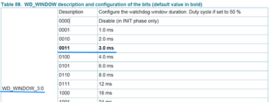

Also if I try to set the WD_WINDOW value to 0, similar reset is observed while accessing the register itself. Currently the WD_WINDOW is set to 12.
However if I monitor the FS0B_SNS sense every time the watchdog is triggered correctly (through a timed event) there is no issue observed but it takes time to release the FS0B pin.

There was an issue during a function call to set the wd_window value. Its functional now and FS0B is released.
I have one following querry,
If watch dog is turned off and the wd_window value is set to 0, will the SBC go back into the INIT_FS state ?

Hello Aditya,
If watch dog is turned off and the wd_window value is set to 0, will the SBC go back into the INIT_FS state?
[A] Do you mean, that you have properly refreshed the watchdog during the INIT_FS state and entered NORMAL_WD state? If yes, than you need to send a periodic watchdog refresh. It you have set the WD_WINDOW to 0000, this value will be valid only during the INIT phase. In the NORMAL_WD state will be the WD_WINDOW set to default value 3.0ms.
After each incorrect watchdog refresh, the Watchdog error counter is incremented.

It appears that on a sbc where FS1B is enabled/ available, for FS0B to be released the test fs1b has to executed atleast once through a spi command.
It is observed that after running and releasing FS1B, the FS0B is released.
Let me know if this behaviour is acceptable.
