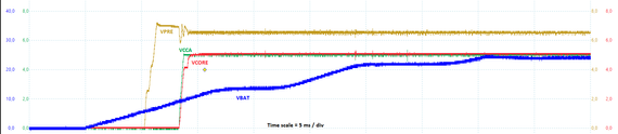

One of our prototypes has failed and the effect seems to be FS4503 pulling fs0b low. Upon diagnosing further, ABIST1 is failing, but I can't figure out why.
According to the datasheet (Rev. 7.0), in ABIST1 the following is checked:
So I have checked the mentioned voltage rails and they are fine.They rise within 10 ms from power-on which is well within the spec'd time before ABIST1 starts. Voltages are stable and stay stable.
The power supplies' DIAG registers (DIAG_CPRE, DIAG_VCORE, DIAG_VCCA, DIAG_VAUX, DIAG_VSUP_VCAN) show no faults (only undervolt directly after power-on, but only for 1 read. After that one read, no errors at all.) So no UV, OV or ILIM or TWARN present.
The DIAG_SF_IOs register shows that there are no IO faults (Rstb_Diag, Fs0b_Diag are both 00, as are other faults). Further, DIAG_SF_ERR shows no apparent faults (FltErr is 2 as expected with ABIST1 failing, but V2p5_M_A_Ov, V2p5_M_D_Ov, Fcrbm_Ov and Fcrbm_Uv are 0).
In short: according to the table, ABIST1 should not be failing. Am I missing something? Does anyone have any pointers as to what else to test for?

I don't remember exactly where I found any specced time. I think I inferred it from TRSTB_POR in the datasheet. If you check the following diagram, you can see ABIST1 is done after approximately 16.5 ms.:
This time coincides with 12.5 to 24.3 ms for TRSTB_POR:
So it's not exact science, and I might have been wrong.
