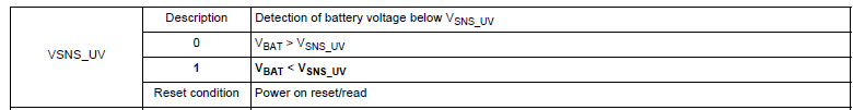

Errors Observed: VSNS_UV=1, FS0B_SNS=0, RSTB_EXT=1, FLT_ERR=6,SPI_REQ=1

Now, I activated periodic watchdog refreshes and FS0b line is released.But still i encountered below errors in driver:
VSNS_UV=1,RSTB_EXT=1,SPI_REQ=1
Input to sbc is always 12v then why VSNS_UV is set?
In Init part of driver ,DIAG_VSUP_VCAN register is readed to clear it ,even though why VSNS_UV is set?.
In which scenarios SPI_REQ bit will be set?
what is the meaning for RSTB_EXT(External) set?

VSNS_UV bit in the DIAG_VSUP_VCAN register is an image of Vbat. After a POR, VSNS crosses VSNS_UV and consequently VSNS_UV flag is set:
As you correctly stated, reading DIAG_VSUP_VCAN register (0x2000) is required after a POR to clear this flag. Are you sure you are reading this register correctly during the initialization phase?
SPI_REQ indicates an invalid SPI access:

1.Reading DIAG_VSUP_VCAN verified by SPI_G bit and communication was successful.
But some how VSNS_UV was not cleared .
Is there is any other check points?
2.what is the meaning for RSTB_EXT(External) set?
