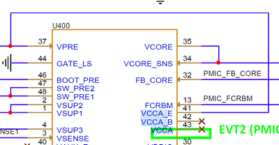

FS45 VCCA without capacitor will cause RSTB cannot pull High
1,663 Views
Eason_L
I don't need VCCA feature, here's my circuit. After testing, it requires a capacitor connect VCCA to GND, so that it can work properly. What's the possible reason may cause this issue?
1,658 Views
guoweisun
HI
VCCA本质上是个LDO,LDO最小系统是由CIN/COUT 组成的,假如缺少了COUT LDO 便不能正常工作,FS也会报错,另外:
VCCA is a linear voltage regulator mainly dedicated to supplying the MCU I/Os, especially
the ADC reference voltage.
